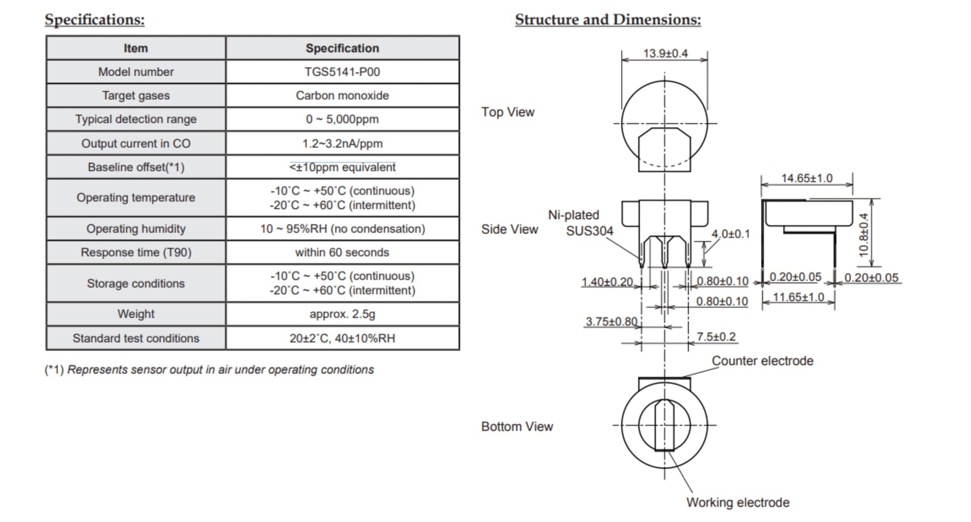

Secondly, most low-cost CO sensors are not particularly accurate. For example, one common sensor (used in the Amazon Smart Air Quality Monitor and the Air-Q Basic and Pro) is the Figaro TGS5141. Unfortunately, based on its own specs, the baseline offset is <±10ppm, meaning that up to 10ppm, the sensor may not record any concentration. As I said in my Amazon Smart Air Quality Monitor review:
Considering that outdoor concentrations rarely exceed ten ppm and that indoor concentrations will likely only exceed that concentration when smoking or, potentially, cooking, this has very limited usefulness. Is there a disadvantage to having this sensor included? No, but it definitely shouldn’t be relied upon, and its usefulness is questionable. I would’ve much preferred to have seen a CO2 sensor included, even if it would’ve increased the price by $10.
