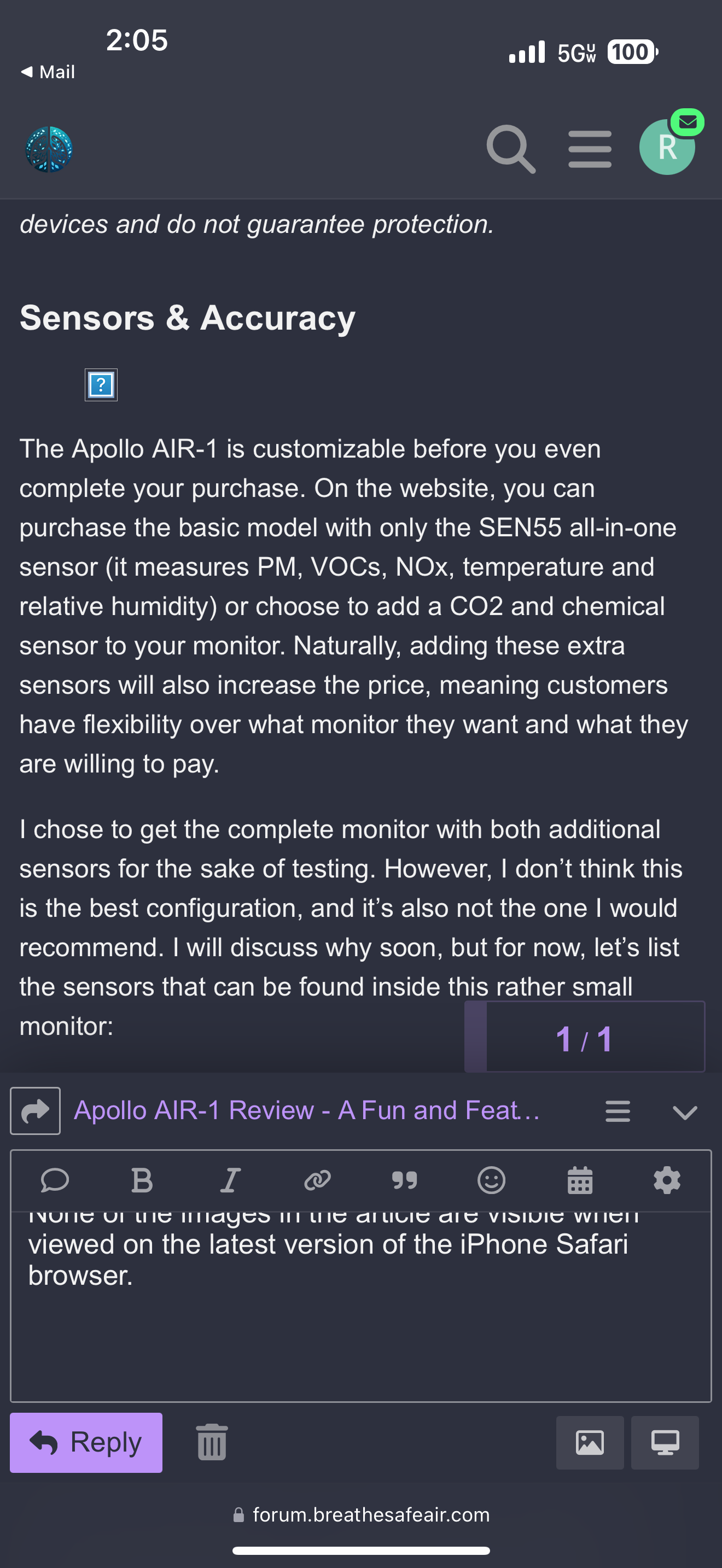

None of the images in the article are visible when viewed on the latest version of the iPhone Safari browser.
All images are displayed as a ? In a box
Thank you for the heads-up! There appears to be an issue with displaying the images from the original post here: Apollo AIR-1 Review - A Fun and Feature-Filled Air Quality Monitor
I think since the images are from a different URL, they can’t be displayed here. I will look into the issue and see if I can remedy it for future posts.
