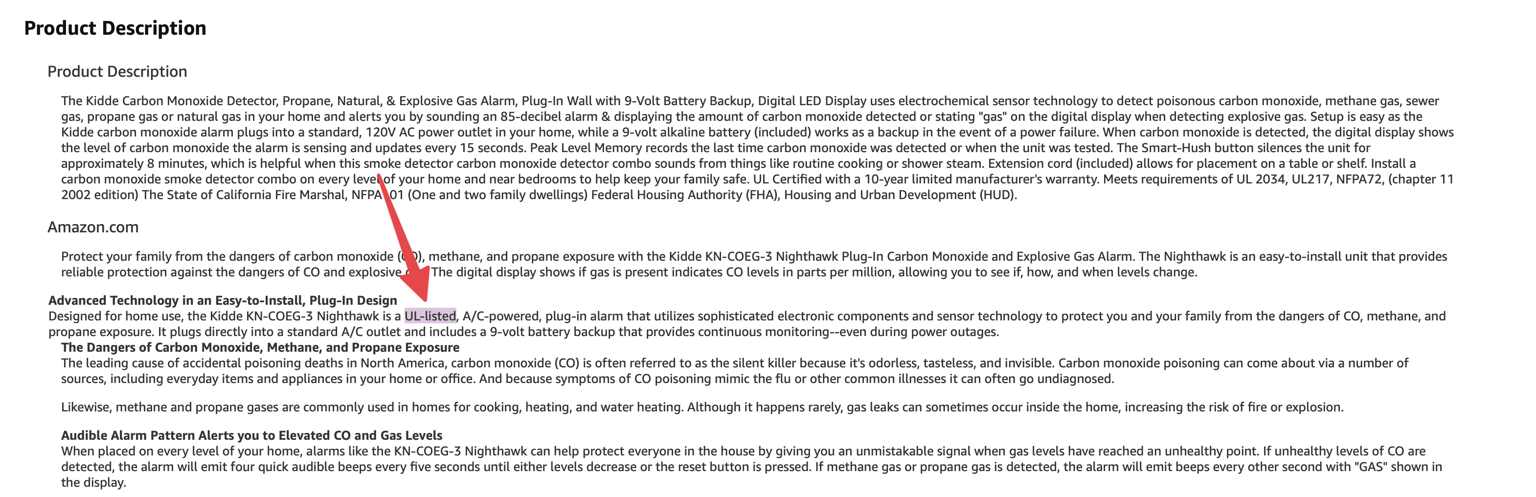

One thing I think is very important with CO detectors (above other gas detectors) is that they are certified. CO is a potentially lethal gas, and I would only ever opt for something that is certified and, therefore, can be trusted. In the case of the U.S. and Canada, it’s important to look for UL-certified (UL 2034) detectors. In the EU, you want to look for EN 50291.
It seems that both of the monitors you’ve mentioned are UL-listed.
Kidde:
First Alert:
I also had a look through both websites and spec sheets (which I would trust a lot more than Amazon listings), and these look to confirm that both are UL-listed.
To answer this, I actually quite like the idea of the two-in-one monitor. Overlooking other features, I think having an explosive gas sensor (methane, propane, etc) would be a nice added peace-of-mind feature. With that said, the Kidde device in question looks to have quite bad reviews. Also, while the device is UL-listed, I can’t find an answer as to whether this only applies to the CO sensor and features or also the explosive gas sensor and features.
For this reason, I would probably go for a dedicated CO device and look for a separate (and certified) explosive gas device if that is something that you want.

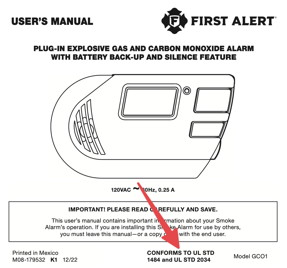

Actually, I just found this monitor:
https://www.firstalert.com/us/en/products/alarms/carbon-monoxide-alarms/gco1cn-combo-explosive-gas-and-carbon-monoxide-alarm-with-digital-display-gco1cn/
As per the product manual, it conforms to UL 2034 (CO) AND UL 1484 (for Residential Gas Detectors). Perhaps I missed this for the Kidde device, but I would probably opt for something like this instead, as it’s clearly been tested for both and appears to have quite good reviews as well.

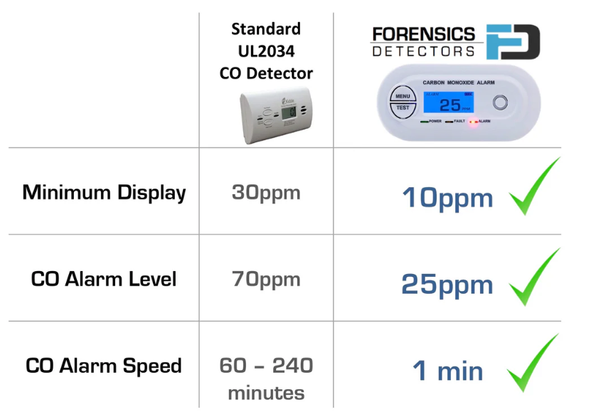

Both your options are solid, but I discovered something important - most standard detectors (including those models) don’t alarm until 70+ ppm, which can take hours. That’s pretty late for safety.
I ended up with Forensics Detectors low-level CO detector that alarms at 25 ppm in just 1 minute. Much faster warning before CO builds to dangerous levels. Since you’re in a gas-heated apartment, this quicker response could be really valuable.

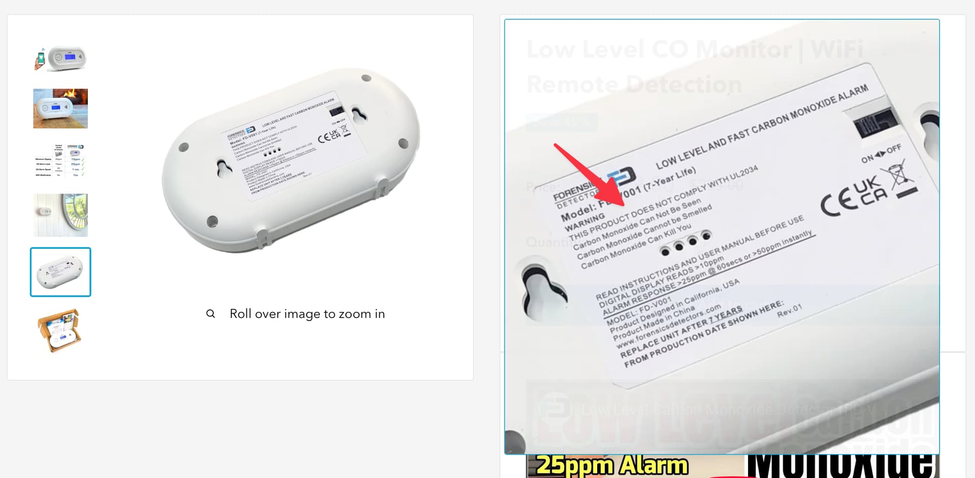

@bryonycannon, this one looks interesting but I want to mention the lack of UL compliance. With that said, these kinds of ‘low level’ CO monitors shouldn’t be used as a replacement for a certified CO alarm and rather act as an early warning system. I think both absolutely have their place (and I use both a ‘low level’ monitor and an alarm), but I want to emphasise that monitors like this should not replace certified CO alarms.

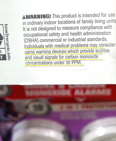

Low level units are NOT UL2034 because they dont follow the UL2034 alarm algorithm, which is first alarm at 70ppm at 60 minutes. Low level units typically are more sensitive and faster to alarm than UL2034 algorithms and hence, for those that want to compliment their existing UL2034, one should seriously consider it. For example, Forensics Detectors low level alarms follow alarming at 25 ppm at 60 seconds. Much faster than UL2034, and useful for elderly, young, families and those that want earlier warning.
Also please note, UL2034 does even alarm at OSHA exposure limits. So please send the message that UL2034 is not end all be all when it comes to CO detection and early warning.
Here is a image of a typical disclaimer people often miss when purchasing a UL2034 CO detector.
Also, Yes, I use it with the Tuya app and it works really well!

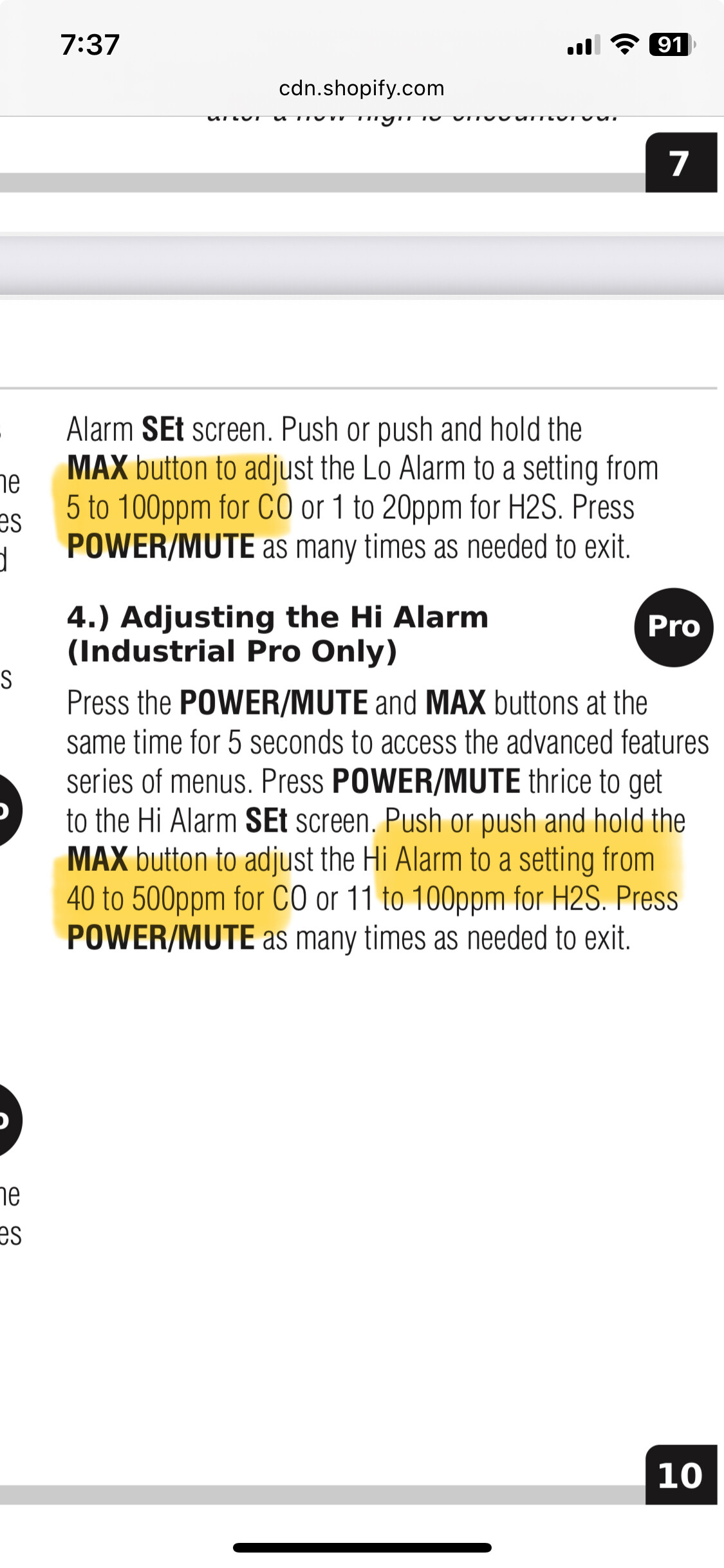

@Ethan the SensorCon units all have alarms but the Industrial Pro model has configurable alarm levels down to 5ppm.

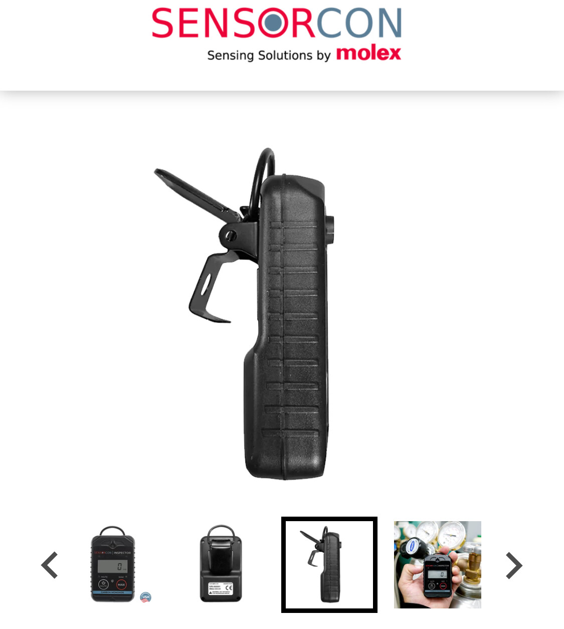

The Sensorcon units have a loop and clip on the back. Makes it easy to position
near head level when working in a kitchen, to hang from a luggage strap when traveling in old buses, and so on.

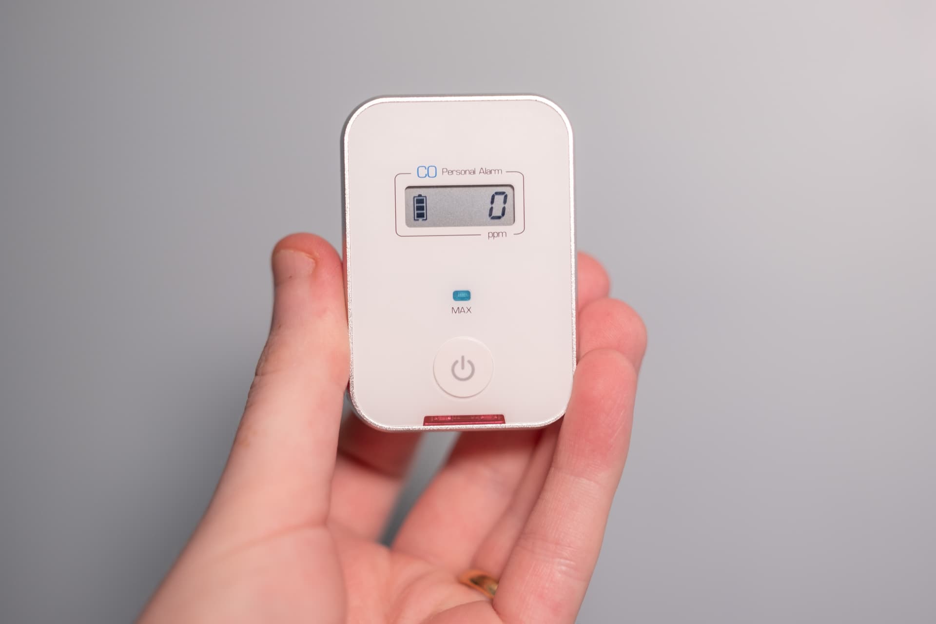

As an update to this thread, I’ve been using the Forensics Detectors Travel CO Monitor for the past few weeks and it’s been quite a handy little device. As someone who travels all the time, this device has been very convenient to carry with me wherever I go - whether it be an AirBNB, Hotel, or back at home. I also appreciate that FD provides a clear End of Life date on the device.
I’m looking forward to using it some more and will be providing a full review in the near future. If you’re interested in this device, you can find it here (affiliate link).
