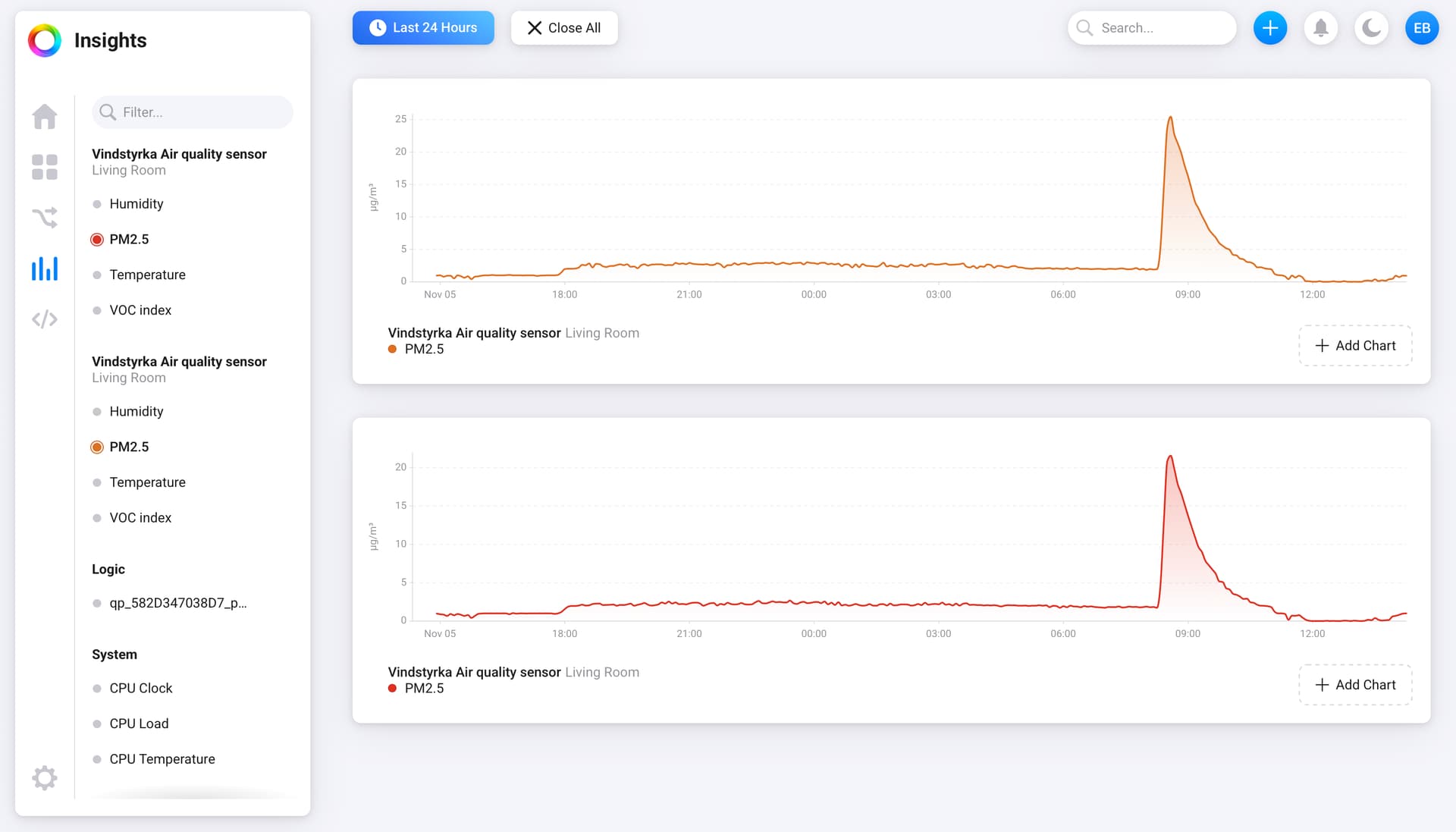

I’ve recently been further testing two Vindstyrka monitors against a reference device and, to do this, I needed to connect them. In doing so, I realized that I made a couple of mistakes in my initial review that I will update when I have time. For now, I wanted to make a quick update here.
If you have a Zigbee adapter for Home Assistant, or another platform like Homey (with the IKEA Trådfri app) you can connect your IKEA Vindstyrkas with relative ease. I’ve had these two devices connected to Homey for the past few days, and I’ve found this to be a far more powerful combination as I’m finally able to access historical data from the two.
If you’re already in one of these ecosystems (or something else that supports these monitors) they are suddenly a far more interesting device - especially considering the very low price.
