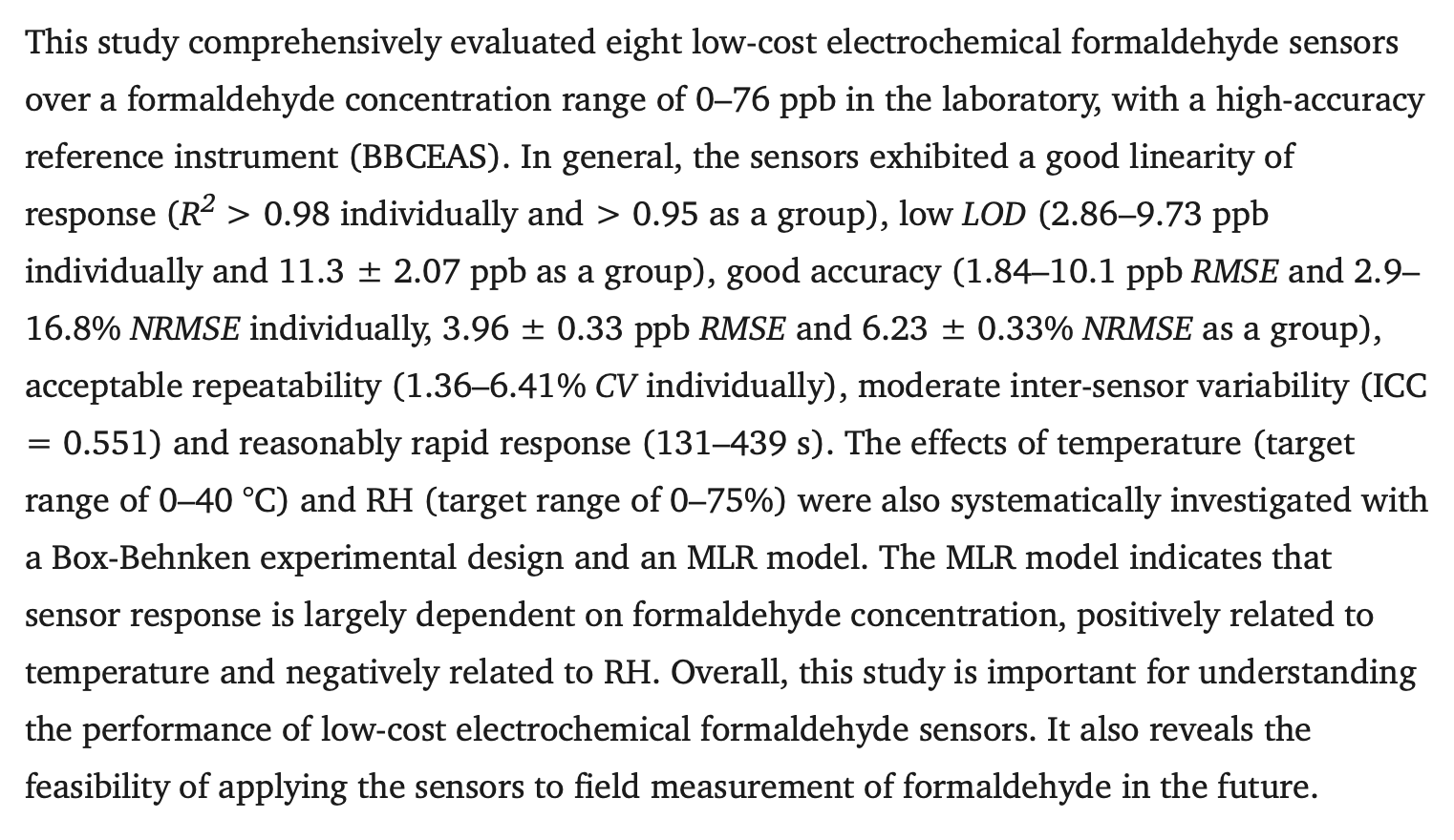

I’ve had a bit more time to look into this and it looks like some consumer-level sensors do a decent job of monitoring formaldehyde levels. For example, here is the conclusion of a study looking into the Sensirion SFA30 (full study here: Laboratory Performance Evaluation of a Low-Cost Electrochemical Formaldehyde Sensor - PMC). Unfortunately, I couldn’t find too many other studies on low cost devices (at least, not ones that named the tested devices).
Unfortunately, even the better low-cost sensors have quite large error margins and LOD (level of detection), meaning they aren’t ideal at low concentrations. With that said, a good sensor like the SFA30 should at least give you some insight into the formaldehyde concentration.
Unfortunately, it’s very hard to find which monitors actually use this sensor… It seems to be in a few air purifiers, but I haven’t found a monitor that uses it yet. It appears to be even tougher to find academic research on monitors themselves (such as the Temtop device). I find this very odd, as for other pollutants (like radon), this kind of information is generally quite easy to find.
