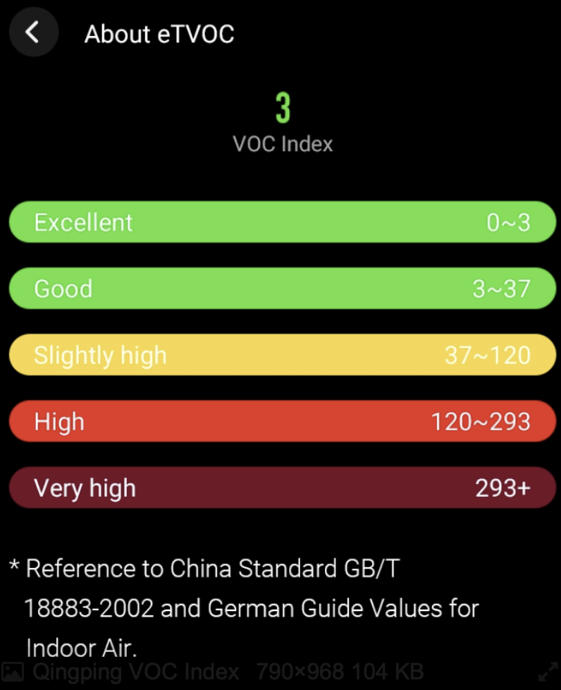

I’m reading 90 on the eTVOC index (or 491 ppb) in the living room, now I’ve been dealing with a persistent dry/super mild sore throat for about 7 months now and it could be any factors of course, went to docs and they can’t find anything, but anyways, is that reading something to be concerned about, in your opinion? Oh and we did get a new furnace few years ago so not sure if there would be an issue with hvac. Thanks!
Hi, @rgeysbeek. Thanks for joining the forum! I’m glad you’re enjoying your monitor.
Honestly, it’s tough to tell exactly how the Qingping device works regarding eTVOC, as they’re not very transparent on the matter. If you’re curious to see a (very) long conversation about the topic, please feel free to check out this thread:
However, based on the screenshot below, 90 should indicate that VOCs are increasing (compared to a relative baseline, which I assume must sit somewhere in the ā€˜good’ range). While the ppb reading is also not ideal (for reasons mentioned at the top of the thread I linked above), it’s probably a better measurement to get a general overall of your VOC levels in the longer term. The index is always adjusting, and therefore, isn’t good for identifying much other than decreasing, steady, or increasing levels of VOCs.
