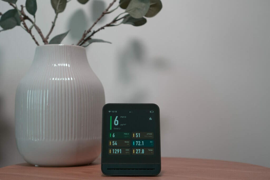

So, small update: I bought the Qingping Air Quality Monitor Gen 2 as it seemed like a good option that I could actually use after the testing. I also bought it as it will arrive by tomorrow, letting me start testing by Friday. I will update you soon once I start testing! Do you have any ideas about possible solutions I can try? Right now I will probably test with air purifiers, and plants (even tho they will likely not make a difference, they will help my presentation and study). I also can test with simple window ventilation for some, but many classrooms do not have access to windows, and/or have students with allergies which could increase with this type of ventilation. So if you have any ideas on what can improve air quality, feel free to share. I will also search on my end. Thank you again for your help through this project!
To answer your question, yes I should be able to leave the monitor on for multiple hours. I will also have to test in different schools so the monitor will stay the entire day, or an entire morning/afternoon which will probably be easier than having to come back more often. Thank you again!
Good choice! I don’t know if you’ve already seen this, but I have a full review of the device here:
Long story short, I think it’s a great monitor!
I don’t think you will be able to notice any difference with plants (from what I’ve read, you need a LOT of plants to make an obvious difference), but it’s worth trying!
This is a great idea, and I would suggest looking at both CO2 and PM trends when the windows are open. I would expect CO2 to drop, but PM may increase depending on the outdoor air quality where you live. I’m not sure if the classrooms also have some other form of ventilation system (or even something like AC), but it could be worth testing these as well if you are able to.
This is great as it will give you a long enough period to draw some conclusions from. The longer, the better - but obviously within the constraints of what you can feasibly manage for this project.
