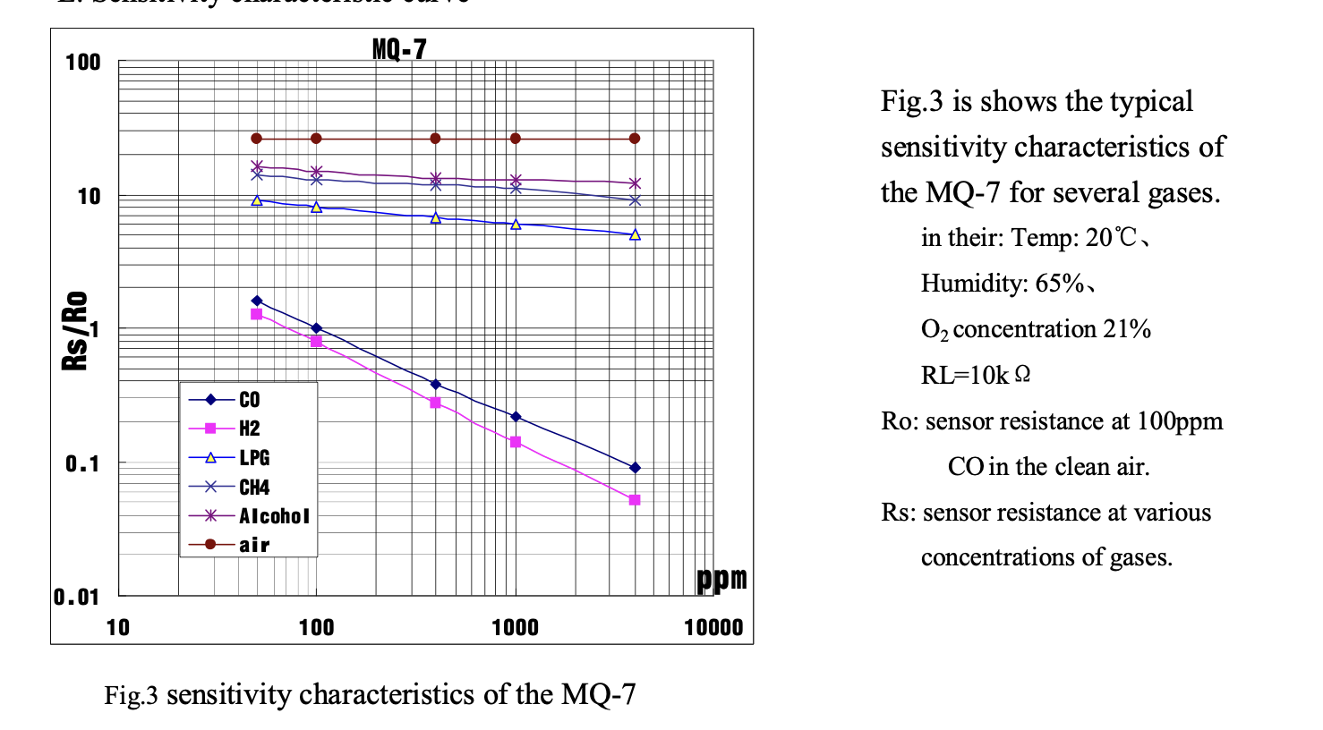

I am currently looking at low cost CO sensor such as the SEN0132. PID sensors for CO and HCHO should be more accurate but they are over the budget.

As for the CO sensor, the SEN0132 (MQ7) appears to have several cross-sensitivities, and it also only has a detecting range of 20ppm - 2000ppm carbon monoxide. 20ppm is already enough to have health consequences (over longer periods).
The SEN0466 (electrochemical) looks to perform much better in both cross-sensitivities and detecting range. Of course, it is much more expensive, but I think this would definitely be the sensor to go for if you don’t mind the extra cost.
