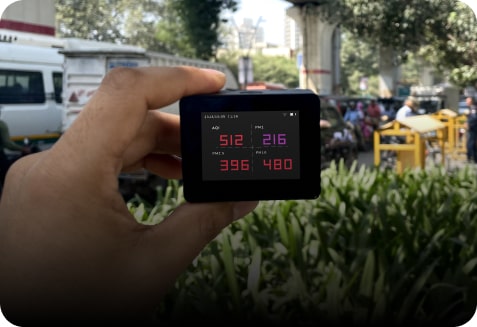

I wanted to request a review for one of the indoor air monitors by Praan Air, which has emerged as a popular company in India since I was considering getting one for my own home back in Mumbai:
It comes in the budget category and I’m not sure if you would be able to review it since shipping might not be possible, but this is a link to it’s brochure:
Until we are able to get a piece and do a comprehensive review, would it be possible for you to comment on the quality of the specs, and maybe compare it with the existing budget category ones (it would really help me in making a decision about it). Here is a screenshot of the specs for your reference:

It’s hard to know for sure (without knowing the sensor they use in this device), but the specs look very comparable to most other monitors - even those significantly more expensive. The normal accuracy bands for sensors like the Plantower PMS5003 and Sensirion SPS30 tend to be ±10ug/m3 at < 100ug/m3 and ±10% at > 100ug/m3. With this in mind, the Pocket PM monitor has a slightly worse stated accuracy, but I don’t think that it’s significant enough that it would make a difference.
One thing I would keep in mind - and this doesn’t just apple to the Pocket PM, but to almost all consumer-grade air quality monitors - is that the PM10 readings are likely very inaccurate. I wouldn’t rely on this, and would only pay attention to the PM1.0 and PM2.5 readings created by the device.

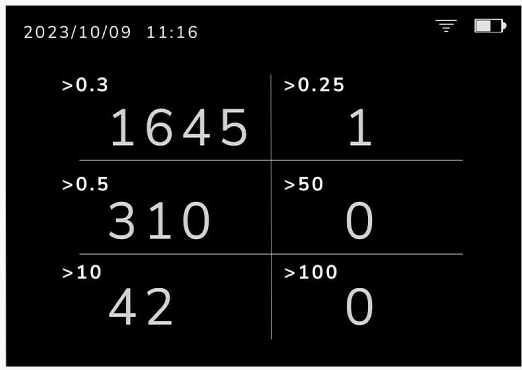

I see they also advertise showing particle counts (as seen in the screenshot above). I would be very hesitant to trust these readings, especially for anything larger than PM10.
Again, it’s hard to tell based on specs alone, but I would say this likely has decent accuracy when it comes to PM1.0 and PM2.5. However, be careful with the PM10 concentration and the individual particle counts. This, however, is something common across all low-cost devices.
One more thought just came to mind. Do you know how often this device takes measurements? I see that it has quite a small 400 mAh battery, and they advertise 4-hours of screen time. I worry that this may mean the sensor has quite a low sampling rate which may reduce usefulness.
I hope that helps! Please let me know if you have any further questions. I am also excited to try these devices myself in the near future and I will be sure to share more thoughts once I am able to.

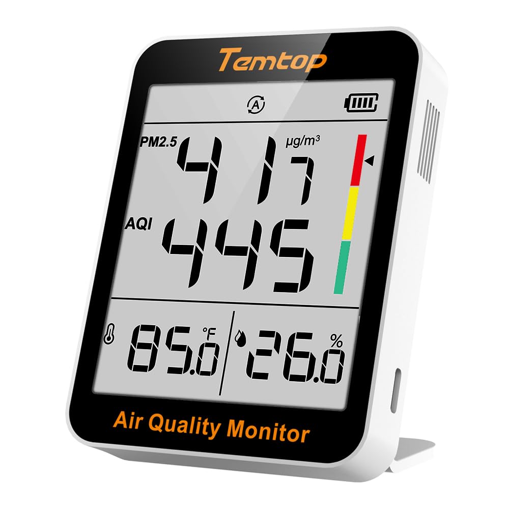

Out of curiosity, are the Temtop and Qingping devices available in India at reasonable prices? They also have a few budget-focused options that can be decent.
Thank you so much for such a comprehensive repsonse, @Ethan. And sure, while it might take a few months, I look forward to the Praan Air device reviews. I am not sure of the sampling rate btw.
Yes, the Temptop is available in India, and they have a nice budget variant:
No budget variant is available for the Qingping devices though. I also have the option of buying the IKEA Vindstyrka one for 40 euros.

I reviewed this unit (or perhaps the one above it - I think this is the S1) a few months ago and you can find the full review here: Temtop S1+ Review - The Most Affordable Portable Air Quality Monitor. It’s a decent unit, but the main issues stem from a lack of transparency about how the data processing work. With that said, it’s an okay unit for occasional readings and getting a general overview of the air quality.
Perhaps I can try reaching out to them regarding this. It could make quite a big impact on the usefulness of the device, so I think it’s worth asking at least.
