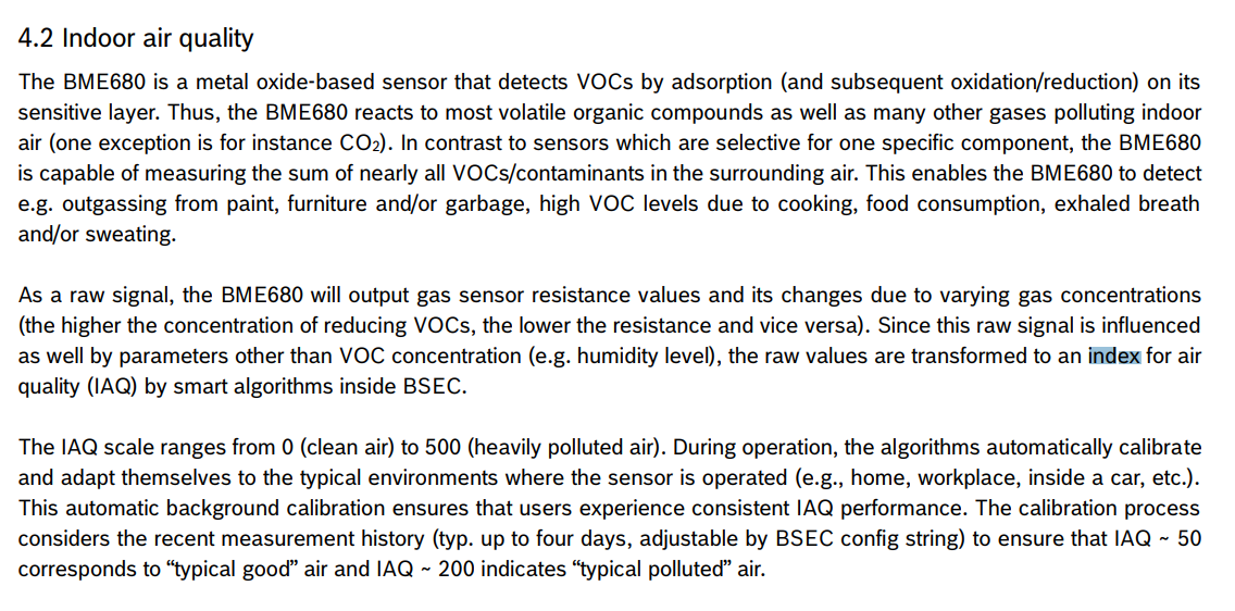

Many people don’t know that these sensors show an index by default - not an absolute value. Below is an explanation of the index used by default for the BM680.
From Bosche BME680 datasheet.
In short, since the absolute values from VOC sensors aren’t very reliable (more on that soon), the companies that produce the sensors have generally opted to use indexes instead. In Bosch’s case, the VOC sensor adapts and calibrates itself frequently to set new baselines. This means an IAQ of 50 should always mean ‘typical good’ and 200 ‘typical polluted’ regardless of your environment. In other words, this number helps identify trends but not absolute values.

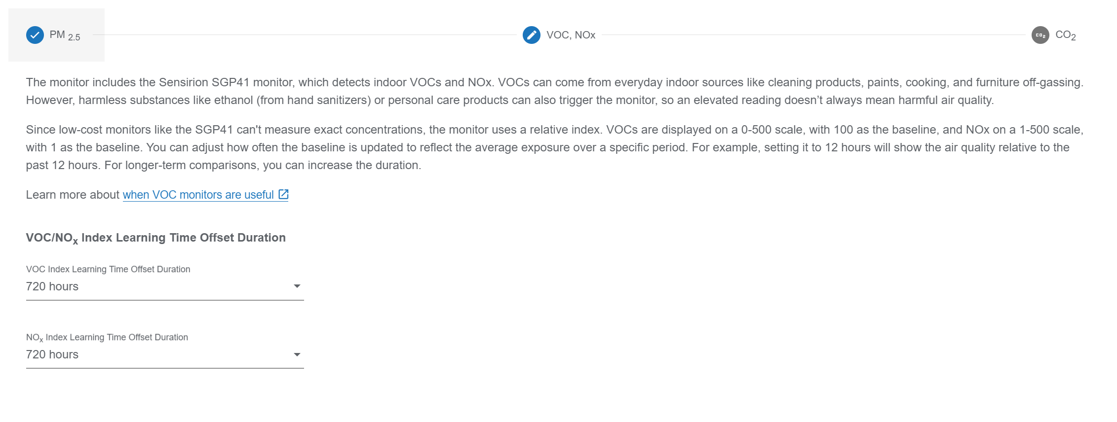

One final note is that since these sensors regularly readjust their baselines (depending on the period set by the air quality monitor manufacturer), overall trends shouldn’t be trusted - only short-term trends over a day or less. Some monitors will allow you to adjust the autocalibration period, but it’s not common.
