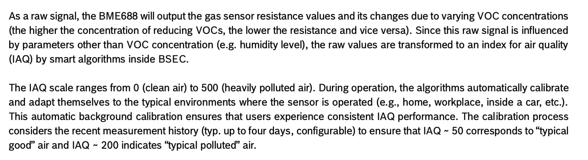

Based on this datasheet, Bosch also outputs an index by default (similar to Sensirion).
AQMD also tested the accuracy of the VOC sensors in the PurpleAir monitors, and the results indicate the BME688 (and previous BME680) can pick up spikes and some short-term trends, but they shouldn’t be relied on to show the actual concentration and lose usefulness for identifying longer-term trends. With that said, AQMD’s testing seems to be carried out using the 0-500 index, whereas the PurpleAir map appears to have changed this index somehow.
While it still appears to be using an index (as opposed to trying to implement an ‘absolute’ conversion), it looks like PurpleAir has converted this index to be on a scale of 0-1500.
It’s worth noting that Bosch provides two indexes - IAQ and Static IAQ. IAQ is confirmed as being on a 0-500 scale, but I can’t find confirmation that Static-IAQ (which PurpleAir uses) is also on a 0-500 scale. I have heard it can go higher, but the AQMD testing linked above mentioned it also uses a 0-500 index. Therefore, it’s hard to tell if PurpleAir is using raw Static IAQ values or if they’re somehow converting the 0-500 scale to a 0-1500 scale for some reason. There doesn’t seem to be much information online explaining this. Frustratingly, I also can’t find any information as to what precisely ‘auto-trimming’ means in this case.

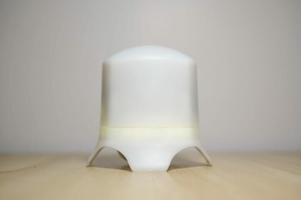

With that said, I think the PurpleAir Zen is a great monitor overall, and it’s the highest-rated outdoor monitor I’ve reviewed so far (I gave it 4.5/5 stars in my review below). It’s a very solid device, with the most significant downsides being price and PurpleAir’s restrictive access to things like historical data. Since you mentioned that price isn’t a big concern in this case, I think the PurpleAir Zen is your best bet.
This, too, is also a reason I really like the Zen monitor:
